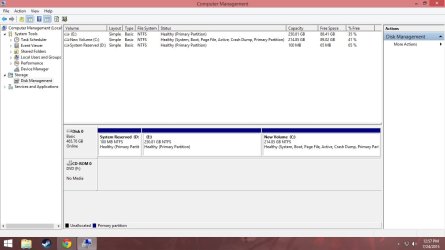

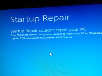

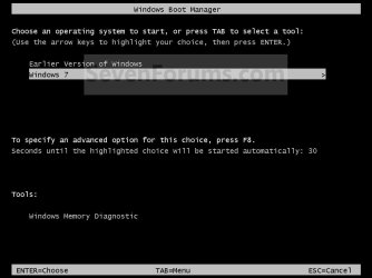

As for the AAM/APM, i dont know how to use it. I maxed the AAM to the right but nothing happened. I tried using another connecter from the PSU also (my generic PSU have two actually) but still it doesnt show. As for the SATA harddisk, I'll find one within this week. My bios actually have a fastboot settings (afaik it doesnt wait for the other pc parts to start to enter boot). I ticked it to enabled but still doesnt work. I ticked every settings under Boot options. And restarted but still it persists. I do have an additional problem. Sometimes, when I'm playing dota2 while using google chrome with few tabs (on windows 8.1) my windows task manager says that my disk is 100% at used. I've opened a few tabs (maybe four) and continued playing. Then my fps spikes up (inside game). It's only a browser so I think thats not normal because I've tried playing dota2 and dishonored simultaneously on win7 but theres no fps drop.
I repeat this started before I even try dual-boot. But I think the UEFI/Legacy is being messed up because Im using Win7 and Win8. I'll try to reformat this week to Windows 8.1 only.
