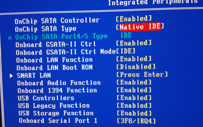

These are the defaults listed in my manual;
OnChip USB Controller
Enables or disables the integrated USB 1.1 controller. (Default: Enabled)
USB EHCI Controller
Enables or disables the integrated USB 2.0 controller. (Default: Enabled)
USB Keyboard Support
Allows USB keyboard to be used in MS-DOS. (Default: Enabled)
USB Mouse Support
Allows USB mouse to be used in MS-DOS. (Default: Disabled)
Legacy USB storage detect
Determines whether to detect USB storage devices, includingUSB flash drives and USB hard drives
during the POST. (Default: Enabled)
But they don't all appear in the BIOS
