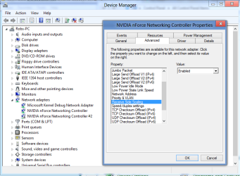

i have had the same issue regarding NVIDIA nForce netowrking controllers, and Windows 7 Home Premium 32-bit, found this article on Microsoft website ...NVIDIA nForce network controller causes a network connection drop in Windows 7
Yes the disable Receive-Side Scaling (RSS fix has been around for quite awhile although the Nvidia drivers have been fixed since then so it hasn't been a problem for awhile, though it may be worth a try.
You can also access that setting in Device Manger at the network adaptor interface without having to use the command prompt.
