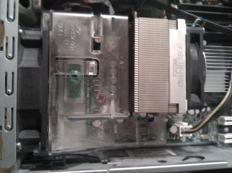

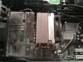

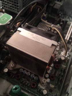

Well if it isn't stable at stock volts I will be forced into using a higher voltage. My first option is going to be 1.4 volts, but I have been questioning whether or not to use 1.45 as I am afraid the air cooler wont be able too keep up.
Here are some pics of the cooler:
I know its hard to judge form the pictures whether or not the cooler will be capable, but the same cooler was used on Core 2 Duos on these HP computers.
