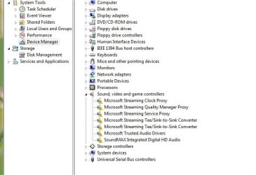

Hello,
I am a new member. I share similar problems and symptoms with regard to "HD audio device soundmax-a driver problem" as outlined by hkhajavi and sikstiks. I have an on board ASUS Maximus II Formula's SupremeFX X-Fi Audio Card with a normal desktop front speaker set up. The sound system was working fine only last week I got no sound come out from the system. I tried uninstall reinstalled the soundMax software and drivers from DVD that came with the MOBO: could not fix the problem then I went to the ASUSTeK Computer Inc. - Motherboards - ASUS Maximus II Formula site downloaded and load the drivers , restart windows...AND Nothing happen. Problem remain.
In the computer management-Sound,video and game controller- SoundMax Integrated Digital HD AudioThere's the "yellow triangle" with the "!" warning sign
earlier in the computer management-Sound,video and game controller also showed the followings:
Microsoft Trusted Audio Drivers.
drivers for Microsoft Streaming Tee/Sink-to-sink Converter (Reinstalling the driver might fix the problem)
Microsoft Streaming Manager Proxy
Microsoft Streaming clock proxy
Microsoft Streaming Service Proxy
Microsoft Streaming Quality Manager proxy...
so now I am back to square 1... I am thinking reintalling win7.... but there must be away without resort to this.

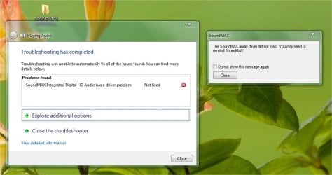

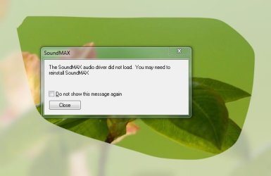

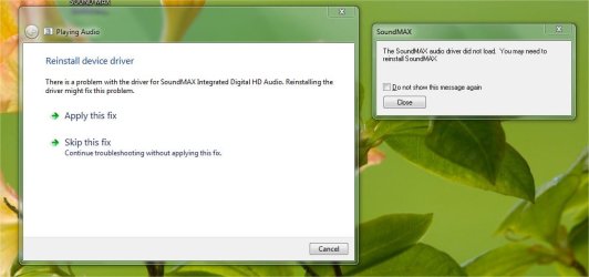

Hello Hopalong
And thank you for your speedy reply.
I followed the steps that you outlined and loaded the soundMax driver in win7 folder with the softwares that
was preinstalled. After windows restarted I got this message
"tHE SOUNDmAX AUDIO DRIVER DID NOT LOAD..Reinstall...". When that didn't work
I uninstall the softwares and repeated the steps and installed the Driver before I installed the softwareS.
I also loaded the latest update "ASUSUpdt-V71601_XPVistaWin7", and installed latest
Intel_Chipset_V9111019_XPVistaWin7 that I downloaded from ASUSTeK Computer Inc. - Motherboards -
ASUS Maximus II Formula.
After all that the problem still remain, I am CLUELESS! :confused:

This is what I would do and did before but is your decision to try or not. I would have suggested this yesterday but didn't have this picture of your Device Manager at that time.
Delete all the yellow marked items under the "Sound, video and game controller."
Right click each yellow item one by one then click delete.
Then reinstall the SoundMax driver.

There is no yellow exclamation marks at all. The sound card is not showing up. Says no device installed.

sassyonyx and id102
In the start menu search box type find and fix
You will see 8 items listed at the top.
First try the Find and fix problems with devices. It is a repair wizard of sorts.
If no help then try this one.
Find and fix audio playback.
If possilbe check to see if you have audio in speakers front and rear panel and/or earphone jacks on front or rear.
