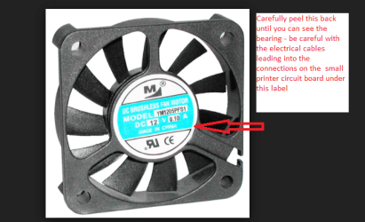

Ok well a simple solution would be to fit a new fan on the cooler but before that try turning the fan with your finger (machine powered off) if it is stiff or it has some sideways movement then I would be reckoning the bearings are out of lubrication or are shot.

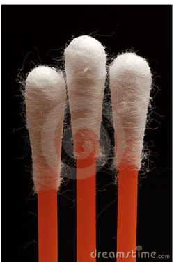

Now if it is lubrication then I personally have relubricated the bearings in many fans before and to do that you remove the fan carefully peel back the label on the back of the fan and it will reveal the bearing usually a porous bronze sleeve which can then be dabbed with a lubricant of some sort using a cotton bud. The lubricant itself I have used WD40 and even light sewing machine oil in the past - but you only need a minimal amount applied to the bearing and then restick the label back. Just put the lubricant i a small container and dip the cotton bud into this this ensures that the lubricant goes directly to the bearing.
Optimally it is best done with the fan spinning - in my computer room I have an old PSU set up to plug components to ie fans in cases like this to do this but you could try just doing it by hand.
If the fan is out of whack ie has some movement sideways (wobbles even slightly) on it's bearing then just replace it - cheap to do and as you know they all come in stock sizes just a matter of measuring the one you have attached to the cooler.
