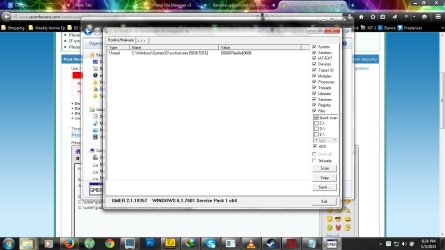

Hi
My system was detecting some strange virus etc yesterday for a brief period of time ... but fortunately avast free version(latest update) .. detected and quarintined all of them. Most their paths were like:
C:\user\public\documents\DELL.exe
C:\user\public\documents\documents.exe
C:\user\public\documents\downloads\downloads.exe
Then I scaned with avast+malewarebytes+supertin ... and all results nothing found.
After google'ing a bit .. I found this article that suggested it could be a possible rootkit infection, so I downloaded .. GMER and with its quick scan it found the following(screenshot attached)
Although it stopped after a while ... I mean the avast detection but GMER still detects something (I'm quite clueless here though) .. however I would like to know if the thing virus or rootkit is still there within my system .. because from what I recall .. i just scanned with the above mentioned security tools and they found nothing ang GMER found something .. that I cant delete (delete button deactive) but perhaps its because the file it detects is part of the OS .. I'm wondering if I didn't delete the file then .. how did it stop and just to be on the safe side .. is there anyway to know if its still within my system.
Finally if anyone knows any security tools that can prevent rootkits or whatever(I'm pretty much guessing here) from entering the system .. would save me from lots of trouble.
Thanks in advance!
Windows 7 Home Premium, Version 6.1 (Build 7601: Service Pack 1)
There are several rootkit scanners you can use. TDSSKiller is the one normally recommended. The link below will give you 4 additional scanners you can use with results that are easier to decode.

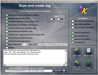

Well if you like you could run a scan with UVK. It will create a log and it might be possible to figure out what's going on.
UVK - Ultra Virus Killer
If you download and install UVK - once installed right click the desktop icon and choose "Run as admin"
On the welcome screen choose "Scan & Create Log" and use the following settings.
Choose to save the log to your desktop and then upload it here. It will take a few minutes to scan.

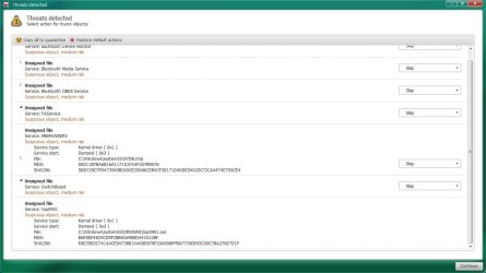

I just ran scan with TDSSKiller and in normal search it found nothing .. so I changed its parameters to "Loaded Modules" and after restart it found couple of items in next scan with all options selected.
I've attached screenshot with suspicious detections(as I couldn't identify them) tabs enlarged ... any ideas?
Also attached the VK scan log
Re: TDSS Killer. I wouln't worry about those results. It shows files that are hidden from Windows but that doesn't mean that they're dodgy. Will llok at your uploaded log.

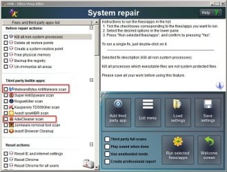

Other Scanners?
Some good advice in the above post. If you kept UVK installed you can just auto-update and run scans with MBAM and ADWcleaner from within UVK's GUI. It will update to the latest versions for you then launch the scan.
You find the third party scanners in the "System Repair" section and if you want to you can add more of your own choices.

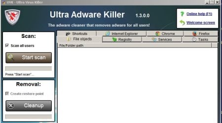

On another note the latest version includes Ultra Adware Killer which in my opinion detects and removes more stuff than ADWcleaner but Ultra Adware Killer is a new release just out of Beta so caution is needed.
