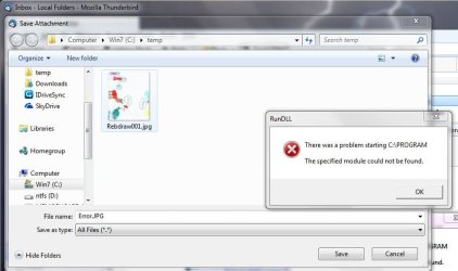

I keep getting this message and don't have a clue where the problem lies. i've searched and found similar, but not identical to this. The attachment says it all.
Normally you get a picture like:
But yours stated: "C\Program"! Most likely somewhere in registry is:
C:\Program Files\somefolder\somedll.dll
but it must be
"C:\Program Files\somefolder\somedll.dll"
or "%ProgramFiles%\somefolder\somedll.dll"
Somewhere double quotes are missing! If no double quotes.... a space is treated like a separator.

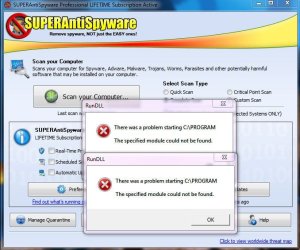

The latest: It happens on my PC also. I rebooted the PC to Windows 7 (normally on Linux) and got "error.jpg". I sent it to my laptop and saved in temp folder. I then opened up Windows Explorer to check on the file and I got "error2.jpg". So I'll include the attachments: error from PC and error2 from lappy.

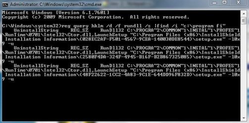

What Troubleshooting Steps have you completed yet?
Have you run Malwarebytes and SFC, established a Clean Boot?
Might as well get started because it's not going to fix itself.
Start by doing following commands in http://www.sevenforums.com/tutorials/783-elevated-command-prompt.html
reg query hklm /d /f rundll /s |find /i "c:\program fi"
reg query hkcu /d /f rundll /s |find /i "c:\program fi"
reg query hkcr /d /f rundll /s |find /i "c:\program fi"
reg query hkcc /d /f rundll /s |find /i "c:\program fi"
post output
reg query hklm /d /f rundll /s |find /i "%programfi"
reg query hkcu /d /f rundll /s |find /i "%programfi"
reg query hkcr /d /f rundll /s |find /i "%programfi"
reg query hkcc /d /f rundll /s |find /i "%programfi"
post output

OK here are both query results:
Microsoft Windows [Version 6.1.7601]
Copyright (c) 2009 Microsoft Corporation. All rights reserved.
C:\Windows\system32>reg query hklm /d /f rundll /s |find /i "c:\program fi"
UninstallString REG_SZ RunDll32 C:\PROGRA~2\COMMON~1\INSTAL~1\PROFES~1
\RunTime\0701\Intel32\Ctor.dll,LaunchSetup "C:\Program Files (x86)\InstallShield
Installation Information\{028EC2AF-F501-4567-9CEA-140030DE8544}\setup.exe" -l0x
9 -u
Installation Information\{2580F4DA-324F-4945-B16F-B2B867325085}\setup.exe" -l0x
9 -u
Installation Information\{48F22622-1CC2-4A83-9C1E-644DD96F832D}\setup.exe" -l0x
9 -u
C:\Windows\system32>reg query hkcu /d /f rundll /s |find /i "c:\program fi"
C:\PROGRAM FILES (X86)\Evernote\Evernote\EVERNOTECLIPPER.EXE REG_SZ Ru
nDLL32.exe
C:\Windows\system32>reg query hkcr /d /f rundll /s |find /i "c:\program fi"
C:\Windows\system32>reg query hkcc /d /f rundll /s |find /i "c:\program fi"
9 -u
9 -u
9 -u
nDLL32.exe
C:\Windows\system32>reg query hklm /d /f rundll /s |find /i "%programfi"
(Default) REG_EXPAND_SZ %SystemRoot%\System32\rundll32.exe "%ProgramFi
les%\Windows Photo Viewer\PhotoViewer.dll", ImageView_Fullscreen %1
(Default) REG_EXPAND_SZ "%SystemRoot%\System32\rundll32.exe" "%Program
Files%\Windows Photo Viewer\PhotoAcq.dll",AutoplayComServerW {00f2b433-44e4-4d88
-b2b0-2698a0a91dba}
-b2b0-2698a0a91dba}
UninstallString REG_EXPAND_SZ rundll32.exe "%ProgramFiles%\Synaptics\S
ynTP\SynISDLL.dll",standAloneUninstall
-b2b0-2698a0a91dba}
C:\Windows\system32>reg query hkcu /d /f rundll /s |find /i "%programfi"
C:\Windows\system32>reg query hkcr /d /f rundll /s |find /i "%programfi"
-b2b0-2698a0a91dba}
-b2b0-2698a0a91dba}
C:\Windows\system32>reg query hkcc /d /f rundll /s |find /i "%programfi"
All %programfi and c:\program fi entries are enclosed in double quotes... nice. Except....
nDLL32.exe
But that's a key name not a value
