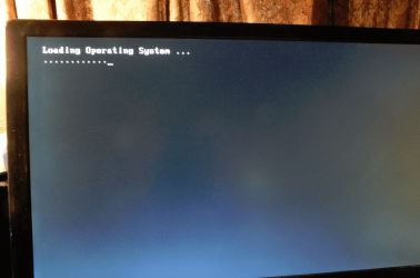

Have installed an SSD and have along the line done something wrong.
Now the problem with the SSD may be close to being solved but it has left me with a boot that takes forever off the HDD's.
I get the usual posts which eventually lead to the screen in the pic - which I have no idea why has suddenly started happening on all three drives.
Could this be a BIOS problem and if so will setting to default settings be the answer please?.

Hiyya Karl the machine is my Desk2 and yes I installed the 7 to the SSD (which I think I have got to redo), and when I boot to that SSD it comes up a very basic system with very few feature and no net connectibiltiy and no ability to adjust the monitor screen resolution.
The first install went fine and I have only reinstalled the 7 the second time because it seems a few files and folders have migrated over form the HDD. Now I know it was probably something I did so I did a second reinstall. But to make sure I am going to do a fresh start with the SS again (3rd time) .
The thing is why am I suddenly getting this Load up screen even with the HDD's which takes so long.
The only thing I can think of is that I have a dual boot 7 & 8 but it is set to boot 7 as the first option if 8 is not selected.

No go Karl have done secure erase, diskpart and OS install three times and the thing will not load any more than a very basic OS.
I cannot get it connect to the net or even get the monitor resolution up to a full 24" screen even though I have installed the catalyst drivers app etc.
So am completely bamboozled as to what the problem is.
The only things I can think of is the OS disk is corrupted somehow, the SSD is not performing to scratch or my mobo has had it.
Plus I still have that annoying Loading operating system screen wit the dots.

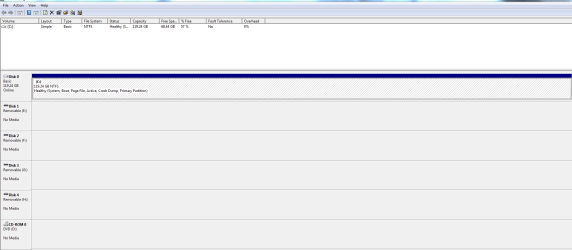

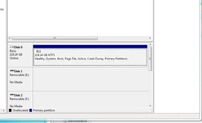

New disk management pic please:
HOW TO POST A SNAPSHOT OF DISK MANAGEMENT DISPLAY
Run disk management:
WIN |
type DISKMGMT.MSC | ENTER
WIN=
key with Microsoft logo on top.
Maximize the output of Disk Management:
ALT-Spacebar
key combo | X key (selects Maximize) |
Drag the field separators (such as between Status and Capacity) to show entire field.
Make a snapshot:
WIN |
type SNIPPING | ENTER | New
Drag the cursor around the area you want to snip.
File | Save as | select save location and name | Save
Post the snapshot:
Post a File or Screenshot in Seven Forums
thanks, karl
MS Windows 7 Ultimate SP1 64-bitAMD A10-4600M6.00 GB Dual-Channel DDR3 @ 798MHz (11-11-12-28)AMD Radeon HD 7660G
AMD A10-4600M
AMD Pumori (Socket FT1)
AMD Radeon HD 7660G
High Definition Audio Device
1600x900@60Hz
Standard PS/2 Keyboard
Here is the shot Karl and James I might even try renewing the cables too.
In any case I think I am going t have to start fron ground 0 again but no probelm as long as I can get the darn thing right.
