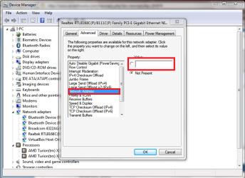

if you tried all the that i said then what you can try is force that MAC address..;)
go to the device manager and double click your network adapter...
then go to the the tab like on the pic copy and paste what you got in ubuntu
this: 00:00:6c:4a:d0:09
restart and check in ipconfig to see if it was able to stick the mac address..;)

can u please give the detailed steps for changing the mac address please :D

@darkassain
go to the the tab to look to at the pic that i have inserted
where is the pic???

thanks buddy
by doing mac spoofing its finally working[:D]
then go to the the tab to look to at the pic that i have inserted then copy and paste what you got in ubuntu
if this doesnt work then you might have to reinstall windows..
Damn, .. great solution.
The spoofing of mac address never crossed my mind.
+rep
