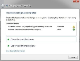

Recently, when I power on my laptop, I was unable to connect to my wifi, but able to detect other wifis. I then tried to troubleshoot it.
After that, it shows 'fixed'(pic5).

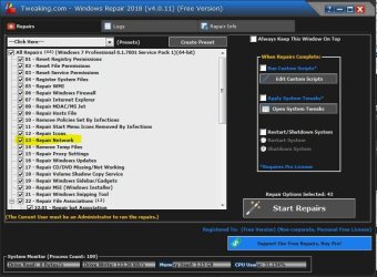

I read online and i found out a software (tweaking.com pic 8) that worked for some people(i personally used this software last time to fix my windows update problem) idk if it will work, please advise.

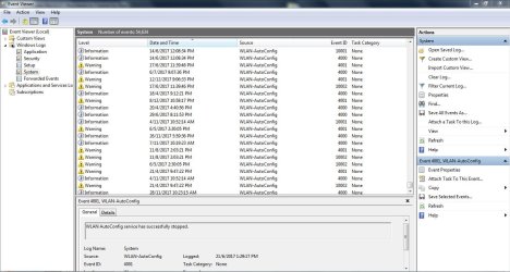

Went to Event viewer and saw some interesting stuff, every time i uninstall and reinstall the driver it shows there in the log
(pic 9) :huh:

I haven't used Tweaking software before, neither I will be able to advise you on its further use.

As for Event Viewer Log, what we see there are your or system attempts to resolve WiFi connection via automatic package / troubleshooter. It's fine to try it but at times like this it is rather useless. You may like to look up for error/warning level of entries in these logs. You do see warning ones on this screen but they hold useless information at this point. You can double click on an entry and look into its content per two tabs available. Maybe you will find something interesting, maybe not. However, you can scroll down to this large list of logs to search for the one when WiFi gets lost or some problem occurred mentioning something about network/wifi and etc. You want to find out why you lost the connection, however, it may not be easy to figure it out alone via these logs - they act as supportive information for your further problem deduction/investigation. The next time you lose your internet connection, there are chances it gets logged in this Event Viewer. Therefore, the moment you lost connection, you can memorise time, so that when you search through this large log catalogue, you could orient by approximate time of connection loss to locate relevant records of interest faster/easier: by time stamp.

I think there are possible tweaks to make in order to enhance own connection, but they come at cost of something else, like, reliability or security and etc, but I cannot go in depth about these tweaks as I am not into that stuff. Anyways, if the mentioned tool was already tried before my reply reached you, and it worked for you - well, then it carried out some of those tweaks probably.
