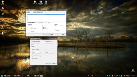

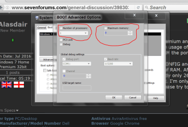

Make sure your system is set like this picture of my systems.
