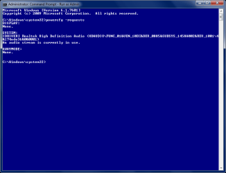

More interesting, i ran the requests in Win 7 and i have a Realtek request.
It doesn't cause me problems, i set a request override years ago, and it still works.
I'm sure i caused the request by playing around with media playlists using media from different devices.

Anyway, my screen print shows what a Realtek request can look like.
