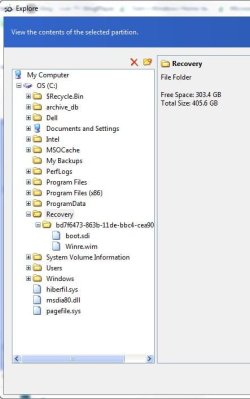

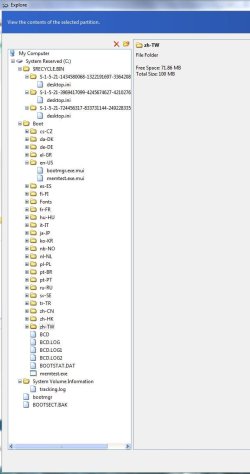

On mine, winre.wim and boot.sdi are hidden away on the OS partition. Sounds like MS did a half-a$$ed job at protecting the Recovery Enviroment if they didn't put those two files on the System Reserved partition.
I copied winre.wim out of there to take a look at it. It's 160MB. Hmmm. Remember somewhere between beta and RC, MS announced they didn't need a full 200MB and started making the System Reserved partition 100MB instead of the original 200MB? I wonder if they originally put winre.wim and boot.sdi in the System Reserved partition but then changed their mind. I guess I could reinstall an older build to check, but it really doesn't matter anyway.
Edit: SIW2, I was writing this and didn't see your last post.

Be a hell of a squeeze even with 200mb - the boot citical files are in there as you can see in your screenie - add 164mb to that ?
