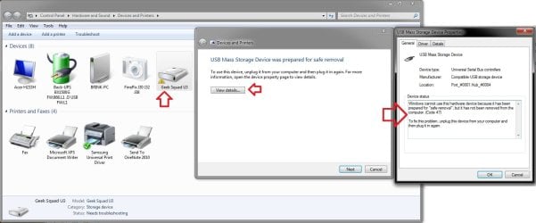

3. Open Devices and Printers.
A) Right click or press and hold on the storage device that you want to eject, then click/tap on Eject. (see screenshot below)
OR
B) Right click or press and hold on your computer device (ex: WINDOWS7-PC), select Eject, then click/tap on a listed storage device that you want to eject. (see screenshot below)
C) You will notice that your device will have a warning/alert overlay icon it now. This only indicates that you will not be able to use this device again unless you unplug it and then plug it in again. (see screenshot below)
4. When you see this notification message below, you can now safely remove the device from the computer. (see screenshot below)

Hi Shawn
i am surprised that in my windows 7 professional i am not able to safely remove my external hdd or pen drive. in the safely remove and eject media icon i am getting only open device and printers. not any other things which i alrady conected to my usb. what could be the issue??? can u suggest me something pl???
Dell/vostro
2GHz
intel
3GB
Hello Manoj, and welcome to Seven Forums.
If you have previously ejected them, then it may take a restart of the computer for them to show back up in "Safely Remove Hardware". Is it connected to a USB hub or to a USB port on the back if the computer? If to the computer, then you might try a differen USB port to see if that may be the issue.
If you open "Devices and Printers", do you have it's drive icon listed there, and can you right click on it and click on Eject?
