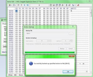

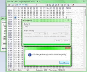

The start sectors shown in the Window tally perfectly with the partition Table shown by bootice. Now you can save the following sectors with bootice.
LBA 0 - the protective MBR
LBA 1 - the GPT header
LBA 2 - GPT Partition Table
LBA 6 - the start of the MSR partition
LBA 33024 - The first NTFS Volume/Partition Boot Record
LBA 732566644 - the last sector
and the backup of the GPT header (I know for sure that GPTdata will be there here.)
LBA 732566640: n-4=732566644-4=7325666410- this should be a byte by byte copy of GPT Partition table at LBA 2. Just check and confirm. Your drive is a 4096byte sector size. I don't have a more than 2tB drive with this sector size to check this.With less than 2TB GPT drive with 512byte sector size this will be n-32
How to save is given in my reference. So I do not want to repeat.

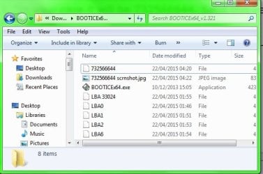

By default bootice will save it to its folder. Name them as LBA0, LBA1, etc., by LBAnumber.
Confirm that all is saved in that folder.
Also note that when you shift from one program to another like PW/Bootice/Windows Disk Management you may have safely remove the drive and replug it for the other program to release it.
I shall come in again only if you need any clarifications. After saving post a screenshot of the bootice folder showing all the saves.
