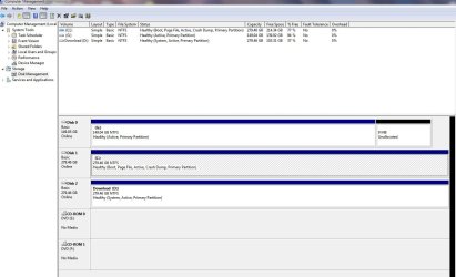

Thanks to Knight Hawk for your input, but I have not had a chance to try anything yet. Could someone look at my dick magagement snap shot as gregrocker suggested? I think the drives are set wrong.
As you will see, G: drive has XP loaded on it.

Assuming C is Win7 and D is XP, since you don't say. Why is G data drive marked active? It should not be.
Install EasyBCD 2.0 beta after doing quick registration to use beta. Remove any XP listing and then Add XP on Add/Remove tab by Name, Type. It will prompt you to add boot files, then autocomplete.
If this fails, what I would do is mark G data drive inactive or move XP drive into DISK0 slot, since the Win7 installer looks for first Active drive to place MBR.
Then run a Win7 http://www.sevenforums.com/tutorials/3413-repair-install.html?ltr=R to correctly configure the Dual Boot as Win7 does when installed last.
Sorry, C: = W7, D: = storage & G: = XP Pro

Something caused the System Active MBR to be placed on D:Storage which is way wrong.
I suggest setting D: inactive, then running a Repair install from Win7 to configure the Dual Boot as Win7 does when it is correctly installed last.
Open an elevated Command line in Win7, type:
DISKPART
LIST DISK
SELECT DISK # (replace # with D HD #)
LIST PARTITION
SELECT PARTITION # (replace # with D part #)
INACTIVE
EXIT
Now run Win7 DVD from Win7 desktop to do a http://www.sevenforums.com/tutorials/3413-repair-install.html?ltr=R with all drives plugged.
With the G drive XP was installed onto that replaced the original 7 mbr entries and why the "missing bootmgr" message was seen. Now it will depend mainly on which drive you will want as the default boot device. If you want the 7 C drive as default you would need to swap cables with the XP drive making that HD0 instead the present G first configuration before making any corrections.
With the present layout the startup repair tool as well as the "Fixboot" and "Fixmbr" commands entered at the command prompt while booted live with the 7 dvd would see the boot information rewritten. You will then see the "recovered" for 7 once the dual boot is configured leaving the XP drive as host/boot. That avoids the need for a repair install of 7.
The ideal option if the 7 install was recent and not loaded up and wanting 7 as the host.boot drive instead would be seeing that plugged in sata port #1 and made the default drive. If needed in the event the boot repair items mentioned should fail to work you see a clean install of 7 later to add XP in as a boot option with the EasyBCD tool.
The Disk Management tool would then show "Disk 0 (C) 7", "Disk 1 (G) XP Pro", "Disk 2 (D) Storage". This would leave the XP drive as a secondary OS drive rather then the host/boot drive for the system.
