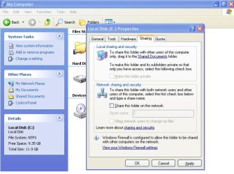

XP doesn't have security tab, it's called Sharing. Right-click on the drive and select "Sharing and Security..."
Screenshot:
