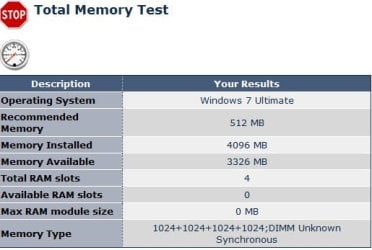

This is what my Win7 Ultimate 32bit is showing
