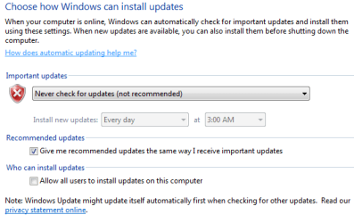

I did set "Never check" but after my running last Simplix (UpdatePack7R2-23.4.11.exe). "Never check" won't work any more. The sign of "Never" (red font) gone.
Any way to get it back? my guess, it needs removing certain hotfixes newly-installed. "Never" was there (red font).
My suggestion is to set Services - Windows Update - Manual and on WU page set it to Never check.
There is a little misunderstand here.
if you open Control Panel\All Control Panel Items\Windows Update\Change settings you can set to "Never Check". This means that Windows will never Automatically check for Windows Updates but will manually check and will install updates that you run to install. Simplix is a collection of Win 7 updates in a single package.
If you just install Win 7, on Control Panel\All Control Panel Items\Windows Update it will show that updates has never been installed. If you run Simplix or install an update it will show the last time a update was installed.

got it.
It's clearer.

Is there an automated way to block all telemetry updates after running Simplex?
As there is no more updates coming from WU, set Services - Windows Update - Manual and on WU page set it to Never check.

That's what I was going to do but out of curiosity I let er rip and there were some Updates. But as you said somewhere they are all long before May of 2023 so must be included in Simplex somehow? Windows 7 don't have Cumulative updates right? It's not to important really but just trying to reacquaint myself with Windows 7 Updates.
