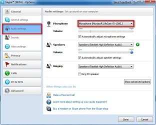

Hello.
So if have the latest skype beta version installed and everything works fine besides the mic. I tried conversations and webcam and i can see and hear everything clearly but no one can hear me.
So i went to the sound setting in windows 7 and the mic works fine. I was able to record my voice using the built-in sound recorder. So i then went to the skype audio setting and the right device is selected but it cant hear me.
The mic works fine on windows live messenger, I was able to have a conversation.
Did anyone have this problem? or have an idea on how to fix this??
Thankx in advance for your help.

Have you tried going into the tools tab and selecting options and audio settings, you should be able to set up everything from there, mine is all working fine.

Yes that's what I did. The device is listed, but it won't hear a sound.
Ok i don't why but it's fixed now. I was making a screenshot to show you how I configured it and skype crashed. I restarted it and it works fine now....
Don't understand what happenned but it works! so thanx anyways!
