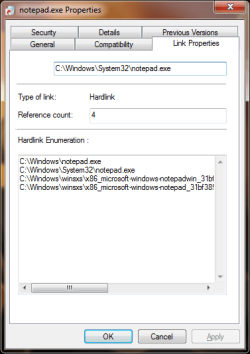

DO NOT MOVE WINSXS. Understand this, moving WinSxS will not help anything, everything hardlinks out of WinSxS moving it just duplicates data without saving space. Below the screenshot shows notepad in 4 locations. However, they all point to the same physical bytes on the HDD.

...*sigh* forget it. I guess I should have bolded "DO NOT MOVE WINSXS" and givin a lecture on the fundamentals of hardlinks.

WinSxS is Windows, every DLL is stored in WinSxS it is the system. All the DLLs and other files you see in system32 or other places all hardlink to the corresponding file in WinSxS. The screenshot of notepad.exe showed it was located in four places, however all of those are just aliases to the same data.
