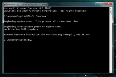

running the scan this very moment, i reinstalled by scratch, booted from a windows 7 usb, formatted everything making it unallocated space, installed and put in a windows 7 key i grabbed from my computer long time back (in case something happened) .
Update:
No errors from first scan, restarting computer for disk check.

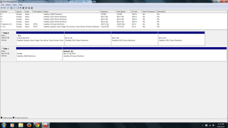

Could you post a screen shot of your Disc Management, please. Include all the information from the Disc Management window.

Wow really freaky. Here check my disk management out.

Hum corrupt mate did you wipe that drive 0 before you installed - normally you shouldn't have to on a reinstall even the repair one but looks like you have ended up with a bit of a mess for some reason.
Have you backed up all the data you really need? because I think you need to store the data via an image or just save the stuff you want to another drive wipe this one and reinstall:(

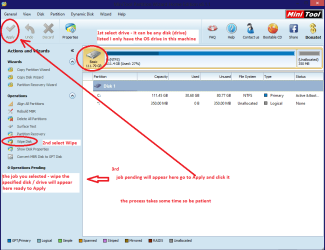

Yes that is ok DNA but it would have been more thorough but much longer at the "clean" input as
"clean all" and you don't really need to assign a drive letter Windows does that by default and it may be why there are so many partitions.
Another option is a disk wipe with Partition Wizard but you may need to have access to another machine and do that using a USB to SATA gadget.
http://www.partitionwizard.com/free-partition-manager.html (very handy tool to keep for future use) see my pic for the process and again it take while to do this.
PS Meant to say you can then follow this
http://www.sevenforums.com/tutorials/113967-ssd-alignment.html
