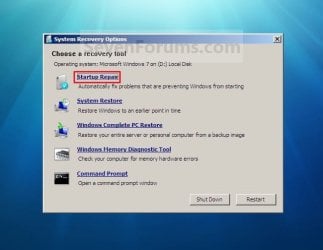

1. Boot to the System Recovery Options screen using your retail Windows 7 installation disk or system repair disc.
2. Select the Startup Repair option. (See screenshot below)
