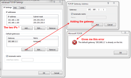

I want to use a static IP address on my Local Area Connection adapter and my Wireless adapter at the same time, cause I switch between the two often, but I'm having a problem.
I know how to set up a static IP address, it's set up and working on my Local Area Connection adapter. These are my current settings:
I'm trying to do the same on my Wireless adapter using these settings:
But I get this error:
I'm not sure what to change the Default Gateway to, so what should I put there?
So far, the only way I can have a static IP address on my Wireless adapter is to clear the setting on my Local Area Connection adapter, but this is a real pain to do every time I switch.

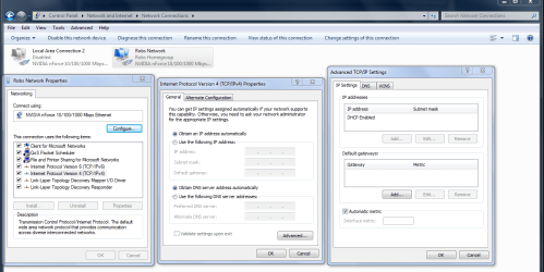

You should be able to go into the TCP/IP advanced settings window and set up both adaptors using that window. Although having the same gateway's for both IPv4 connections might be problematic.
Click on the advanced button at the bottom right of the IPv4 connection properties window to get to the TCP/IP connections window.
The default gateway's should both be the same if you are using the same router for both connections.
First click on the "use the following IP address" and the use the following DNS server addresses, in the IPv4 properties window. Then click the advanced tab to get into the TCP/IP set up window.
You should be able to list both IP addresses and subnets in the upper right window, and both gateway's in the next window down, on the DNS tab you can list the DNS and secondary DNS for both. Use the ADD button for this.
Although I havn't tried doing this myself. Usually the TCP/IP windows is used for two different subnets but it may work for dual IPv4 connections.

It's still not working.
I click advanced, enter in both IP addresses, and leave one gateway so that it looks like this:
But when I click OK, I get this message:
That's because I already have 192.168.1.100 assigned to my wired internet adapter. Here:
I'm starting to think what I want to accomplish is impossible.

If I don't in anything in the IPv4 window, the advanced window looks like this and I can't change anything.

You first need to click where it says "Use the following IP address" in the first window. At that point you will be able to use the "add" button to add your IP's and other info to the second TCP/IP window.
And there is no telling if this will work because TCP/ip is mostly for adding a secondary subnet. Hoping it works for you as I really havn't tried using the TCP/ip window for adding a secondary IP.
