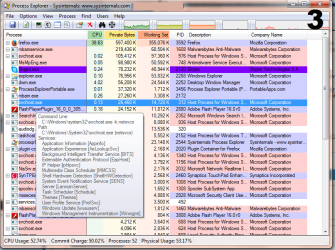

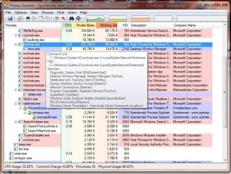

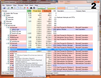

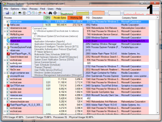

Update:
Same thing happened again this morning, after boot. Very, extremely frustrating. svchost was using over 800MB of my ram, leaving about 300MB for all other applications I had opened, including Firefox, which made everything not responding.
I've managed to capture it and its services when it was at about 700MB+ in Process Explorer, as I was writing this just now. I've also included a screenshot of the same process, after it calmed down.
Strangely enough, the first time it happened today I've switched off the wifi - it stopped after a while, after I've switched it back on, after a moment the process was eating all my RAM again, and after it stopped, it did it again as I was writing this post. Ugh.
1 - svchost using all RAM
2 - calmed down slightly
3 - after a few minutes (3-5)
Update: It happened randomly as I was watching videos on youtube, made everything not responding for 15 minutes, I could not do anything, everything froze because svchost used all RAM
