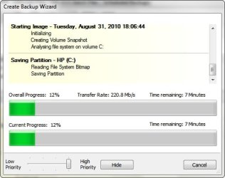

Macrium Reflect works perfectly and 100% reliably both making and restoring Images on my Win 7 computer using my LaCie 2TB eSATA Raid 0 HDD...
Plus it is consistently more than 3 times faster than using USB 2...
