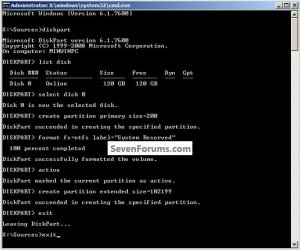

1) Use the info out-lined in this snip to create the "System Reserved" and the Extended to get started, hitting <enter> after each command; don't be concerned with not doing anything further to the Extended, it will be done as you go along.
The size= has to be entered as MBs : 1024MB = 1GB
You may care to have a look at this tutorial for additional information.
The reason for suggesting to create the System Reserved at 200MB instead of the new default of 100MB is an attempt to curb some of the issues we're now seeing with the partition being too small when dual/multi booting and it also being needed for use with the Windows 7 Backup and Restore and BitLocker programs.

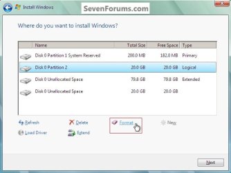

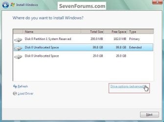

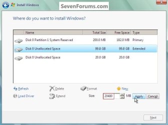

2) Now after you exit diskpart and are back at the installer, be sure to create and format a partition to do the first installation to so you don't have a hard time getting disk management to shrink the first install to a size you want, do not use the installer to format the "System Reserved" partition you created; see these snips below.
Just do the first one to install to, the others can be done using Windows disk management after the first install is complete.

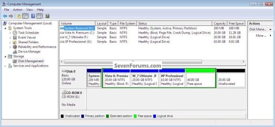

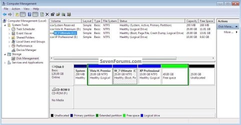

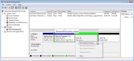

Create the other Partitions
Now after you have the first OS installed go to Windows disk management to create the other partitions you are going to use; right click the free space; if need be view this tutorial for the create / format process, be sure to Label (name) then during the process.

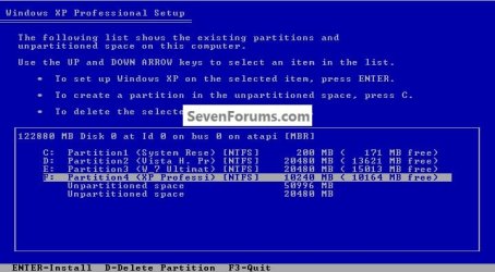

2) And here's the third OS installed.
:note: Note: When XP is installed it isn't intelligent enough to make itself C: and not the "System Reserved" when the SysResv is marked as the "System" volume and Windows will not allow the system volume drive letter to be removed and that may cause issues when installing programs/apps that look for C: in XP during their installation process.

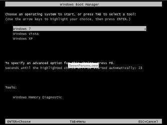

Add an Entry for XP
If you do install Windows XP last as I have, you will have to do at least 3 separate startup repairs with a system restart between each repair to get Windows 7 / Vista booting again as a dual boot; see this tutorial below for the startup repair process.
How to Run a Startup Repair in Windows 7
Then an entry for XP must be added to the Windows (dual/multi boot) boot menu from within Windows 7 using the free EasyBCD program, this is easily accomplished, see the snip below.

*** one thing i do not understand,,,
i am at the point of installing vista hm prem to the first logical partition, step one pic 3 above-
select extended, create 80 gb logical, click format,
the install windows GUI has hidden the extended and logical partition, and now only shows the original 232 gb 'disk 0 unallocated space' in the pane. does the OS intentionally hide the created partitions during format process, or do you think there is a bigger problem within ? i noticed this when tryng to format a primary partition with 7 on an HP machine- thx in advance
