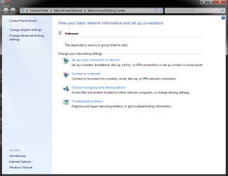

Solved The Dependency service or group failed to start.

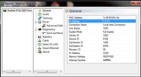

I am having this problem and it started one day when I booted up my PC. I tried resetting the router, modem, a new cable, using netsh winsock reset catalog (reset winsock entries), netsh int ip reset reset.log hit (reset TCP/IP stack)
and none of it has helped. I have updated all the drivers for my motherboard, which is a gigabyte GA-Z68XP-UD3P. On the lan connections I am getting a solid orange light,1000ms connection, and a flashing yellow light which means data is being received and sending (This is in the manual). I have used the program, Realtek-Ethernet Diagnostic Utility which gives me some information that I put as attachments, I'm not sure how to post SS's when the insert picture button ask for a URL. I also posted the Ipconfig which brought back some weird results. I am not sure where to go from here and any help would be great.

According to the ipconfig you aren't getting anything from the router at all so resetting the router would be the first thing to try. :)

He'd tried resetting the router many times, as well as plugging another computer into the same port with the same cable and it worked correctly. He did a good job of trying all the basics. Never did find out why all the services crashed but restoring to a previous point solved the problem for now. The funny thing is that the only thing he did before this problem appeared was to install a card reader. And used the windows driver, didn't install any software or make any other changes. Very strange.
