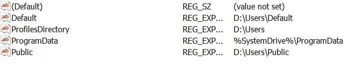

Blink, I've seen cases that sysprep didn't change the default user folder.
Scan the register (F3) and look for C:/Users. Should be any.
Go to this address on Regedit
HKEY_LOCAL_MACHINE\SOFTWARE\Microsoft\Windows NT\CurrentVersion\ProfileList

Is the new account on "C" or "D"?
The new account (that I was able to create in Safe Mode) had been created on D:\ as it should be since I have D:\Users folder set up.
Win-7 Prof 64bit
To clarify, I've not had any issues before this. My Users Folder was on D:\ and everything had been running fine till I had to take out the HDD and used it on another machine (attaching in an external HDD closure).
So sysprep had worked fine, no issues etc. on that account
