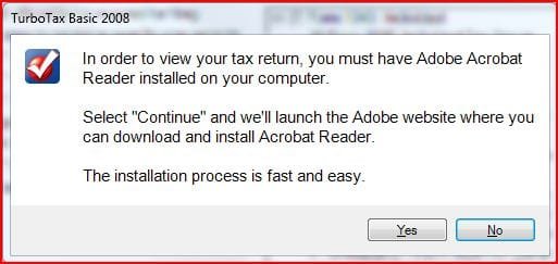

Just to refresh, my TurboTax was installed and running fine. I decided to test, and removed Adobe and installed Foxit. The program will still print normally, but it will not let me save as pdf or view pdf without the type of message below. I would say if you want TurboTax to be able to use all it's features, you need to keep Adobe until after your taxes are done.
Unless you think the IRS would accept such an excuse! :geek:
