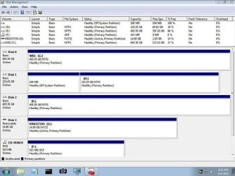

You could take some screenshots of disk management, save it to the usb stick and post it up here.
Also run diskgenius and take a picture of it for everybody to have a look at.
there is a camera icon on the taskbar. Also running chkdsk is a good idea at this stage.

So I ran chkdsk and I've also attached a couple of screenshots from Disk Management and EasyBcd. I don't see diskgenius anywhere though.

1. X: is the ramdrive the boot media is currently using. It is not on your hard disk.
run chkdsk against the hard disk partitions
e.g.
chkdsk c: /f
chkdsk d: /f
chkdsk e: /f
the /f switch tells it to try and fix any problems.
2. the boot media usually autoassigns letter Y to the usb stick. It doesn't seem to have done that, so you can browse to the usb stick, rt click on Uprogs.ini and select "pecmd load" from the context menu.
The boot media is meant to be run from usb stick, not from cd/dvd.
then you will find diskgenius under the start menu \disktools\
There is something odd about what you are doing. When the boot media loads from the usb stick, it should automatically assign letter Y to the usb stick. And then it creates shortcuts on the desktop which point at the programs in Y:\ Uprograms
This is what is on the usb stick:
- - - Updated - - -
is it a problem that the Windows Boot Manager shows the Sandisk (C drive) as P4, but further in the list it is shown as P3?
To boot from the usb in EFI mode Select: Windows Boot Manager P4 Sandisk
To boot from the usb in Bios mode Select: P3 Sandisk
Your disk management screenshot shows an EFI system partition on Disk1. And there are no Active partitions shown ( except the removable usb stick).
therefore it appears your installation is EFI and most likely using the gpt partition style.

I don't know what to say... the computer is certainly doing something odd.
Sorry if I have confused things, but to be clear,
The Kingston is not the USB with the boot media - it is the stick I used to save the screenshots to.
The SanDisk is the drive with the OS.
The boot media is on the Lexar stick.
I don't know why the Lexar is not showing up as Drive Y - there is no drive Y shown in File Explorer, just drive X. The Lexar is also not showing up on Disk Management - again, I do not know why.
I took a few more pics of Disk Management and File Explorer without the Kingston drive and the DVD drive empty. As you can see, there is no drive Y and I don't see the Lexar in Disk Management.
So Disk 1 (the SanDisk with the Windows 7 installation) shows an EFI system partition, but you say there are no active partitions shown. Is that part of the problem?
For an efi installation you won't usually have a partition marked active.
Are you using a usb2 or usb3 port ? The media does contain usb3 drivers, but they might not be the correct ones for your machine.
Try the boot media usb stick in a usb2 port.

I was getting some different messages when I launched Usb7ice, but was able to ignore them and copy the 17514x64v32 ISO to the USB stick. However, when I rebooted, the USB was not shown as an option in the Boot Menu.
I booted back into Windows and the light on USB stick started flashing continuously as though it were being written to or reading from. The graphics started slowing down and behaving a bit erratic. I was unable to eject the USB drive without shutting down the computer.
I used FAT32 as I did with the previous ISO.

I tried copying the 17514x64v32 ISO to the USB stick again - this time on my laptop with Windows 10. It copied without any issues.
Again, the USB did not show up in the Boot Menu of my Windows 7 machine when inserted into the USB3 port. I was still able to boot from a USB2 port and for what its worth, I opened DiskGenius and its now indicating the ESP partition on the SanDisk is damaged. Presumably this is still a problem? I'm still able to boot into Windows as well though, so I don't know what to think.

1.
The motherboard boot menu has nothing to do with the usb3 drivers inside the wim file.
Perhaps the port is a bit dicky.
2. Are you able to boot into windows with only the sandisk attached and no other disks?
