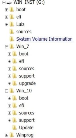

If you make the Rescue Drive on a 8G USB flash drive you don't need to burn a DVD. You can mount the Win 10 iso then copy all files and folders to a folder on the USB flash drive.
You boot from the Rescue Drive then run setup.exe
Mine has Win 7 and Win 10 installations files.
Why do you want to downgrade to Win 10? In my opinion, Win 7 is still a better OS (more stable)
