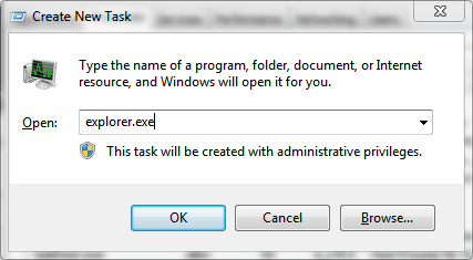

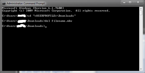

One method you can try is disabling explorer incase that's the cause for the problem...
Start an Administrative Command Prompt... Leave it open
Start Task Manager, Close Explorer.exe
Open the command prompt.
Change to the appropriate directory:
cd "%USERPROFILE%\Downloads" - ENTER
Delete the file:
del filename.mkv - ENTER
Oh yeah, almost forgot. Re-initialize explorer.exe by going back to Task Manager and clicking the File Menu > Add New Task (Run) and type in explorer.exe

THANK YOU, this did the trick. And I only have two. Sometimes firefox hits 300k+ with multiple tabs and a youtube video. Mostly 1080p videos.

It's possible a program is using the file and therefore you cannot delete it, if WHS' method doesn't work, then close all of the programs that you can and try to delete it again.
Well, he tried in safe mode. That should have taken care of it - or not?
Not if it's explorer locking them. I had only luck when I went through an explorer substitute (Q-Dir), and killed explorer through taskmanager.
But I assume that safe mode with command prompt should have done the trick as well

I had the same problem with a .MKV file which was located on my HP home server (WHS). I was able to delete it using the command prompt via a remote desktop session (on my notebook) immediately after rebooting the server and without ever starting windows explorer on the server.
In my case the file name was excessively long and with many symbols so to avoid typing errors I copied the file name from the share which was visible in windows explorer on my notebook and was able to paste it in after the del command.
File unlocker was no help as it said the System had a lock on it.
Thanks for the help given above!
