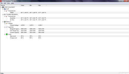

Do a search in Google for CPUID Hardware Monitor. It will show everything.
I ran the program and here is the screenshot:

They seem fine to me. 60 upper limits of acceptable.
It's kind of high to me ....

Guys, I ran hibernate on its own and it works.
About 5 minutes ago, the laptop just spontaneously turned off again and then re-started. So, nothing to do with the critical battery stuff that I was on about before.
I can only guess now that its a overheating problem or maybe a driver problem.

Thanks for helping guys, but as I mentioned above, now it has nothing to do with the hibernation problem that I started the thread with.
I tried hibernation, and it works.
Before, I was using my laptop, it was quite hot, and it just spontaneously powered off. I think this is what happened yesterday too. So far, the problem has occured 3 times.
Any ideas guys?
