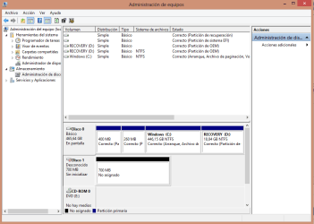

When i connected it via USB i went to the Disk Manager and saw the unit as "Disk 1 Unknown Not Initialized". But there was something else, the disk has a size of 120GB but the Disk Manager shows only 700MB.
The Disk Manager didn't allowed me to format this partition and when I press on "Initialize disk" it didn't do anything.
