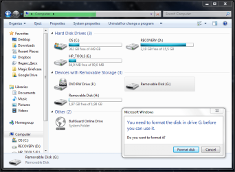

Upon plugging the USB flash drive into my computer, I am welcomed by this message:
attachment.php

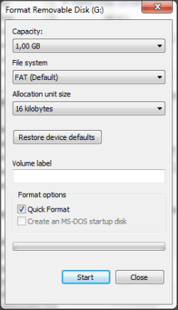

I clicked the format option, and I look at the Capasity in the Format window.. it saying 1GB capacity. There is no other choice.

So I am wondering what is the problem and how it can be fixed? I don't really want to trow away this USB flash drive, as I am using it daily for moving my data between home and school.

I suggest that you download the HP USB Disk Storage Format tool 2.2.3 from Download HP USB Disk Storage Format Tool 2.2.3 Free - Windows-based Format Utility for HP Drive Key or DiskOnKey USB Device - Softpedia , run it as an administrator and format your entire 16GB with Fat32 or NTFS as you may please. (Caution: Recheck and save any data that you may not want to lose)
Hi there, thanks for responding.
When I try to click Start it gives me a error: Device media is write-protected. Hovewer I have none protect switch on my USB Flash Drive, and I don't remmember doing this myself.
So basicaly I cant format without unprotecting it? How would I do that?
m
m
OK, there are many solutions for formatting a write-protected drive.
Try this utility to low level format your pendrive. HDDGURU: HDD LLF Low Level Format Tool
Please ensure that except for the pendrive, there is no other USB drive connected. You may have to run this utility many times to completely remove the error. Also be patient for the low level format to complete and do not interrupt it halfway through. ( Large HDDs may take hours but since your pendrive is only 16GB it may not be hours but still it may take some time to complete.)
Remove the pendrive and then plug it in again. You have to do a regular format, using the HP Format Tool or even Windows 7 Disk Management.
Let us know the results.

I used this tool and it took not long before it finished. I removed and plug it in again and I used the standard windows format utility in order to format it.
And I have 15,9 GB back so I can use the Pen drive again! Thank you for all your help. :)
