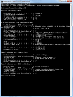

If you can post your ipconfig /all when it says "unidentified network" it would be helpful, example below. I use the built in snipping tool for this. This is usually a router or driver problem, the ipconfig will tell me more.

Yes i have my IPconfig, weird thing is that i have two gateways? :eek:
Yes you have the dreaded 0.0.0.0 default gateway problem although your default gateway shows up below that which is a little different than normal.
This usually means that your router needs a firmware update to work with Windows 7. If you can find more recent firmware for your router you should update the firmware.
You can sometimes get around the problem by typing in the proper default gateway manually. The link below shows you how to do this.
Windows 7 Unidentified Network, Limited Access, No Internet Connection Problem Resolved
