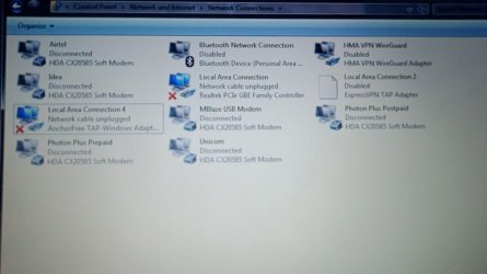

Thanks mate, for offering help. Here are my findings:
I do not have dedicated on/off button for WIFI & there is some Tower symbol on F11, I have never pressed that before. Still I tried FN+F11, no change.
In device manager -> network adapters -> I don't see an wifi option in there. Attaching a screenshot of what shows up for me. In the screenshot - Airtel, Idea, Photon, MBlaze, Unicom haven't been used in years - some of them no longer operate in the country either :roflmao:

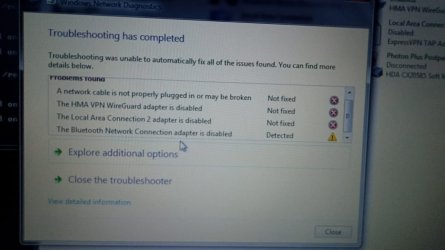

tried windows network diagnostics & it showed the following result, as in the screenshot

Network is only showing Ethernet/Modem connections. however it is showing Bluetooth dissabled.....
(generally that connection IS related to the wifi driver)

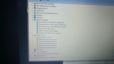

attached device manager photo along with this reply, other than the "Other devices" section, no others have exclamation or any errors showing up in them

anything in Unknown devices IS a problem need to see it

not sure, why the photo didn't go through - it was uploaded successfully. Attaching photo again

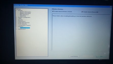

In the BIOS, I found this option.. not sure if I went through the correct setup, plz refer to the photo.
If this not what you were referring, can you kindly let me know - what option to choose when the options popup - Diagnostics, BIOS, Internal HDD & etc..

Hi
NO sign of the Wifi adapter.....not good
i would like you to check a couple of things
from the Bios options, last pic
does your Wifi adapter appear on ANY of the options, especially
System Configuration or System information or Performance and power management
Under Maintainance
is there a system dagnostics option....if so please run it
please also reset Bios to default values.. reboot
recheck that Wifi and Bluetooth are ticked
I would also like you to check the 2 gold wifi connectors are attached properly
(you need to remove the back cover)
Re Other devices
IF any of the above suggestions "repair" the wifi then all the Bluetooth entries will likely be corrected
The base system device is different
select it then Properties(right click) and goto the Details tab then from the dropdown arrow
select Hardware ID and post the pci/vend detail
