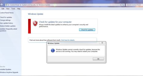

When I try to run windows update now I get a "windows update service not running" although it shows as running in task manager.

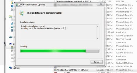

I dl'd and ran the surt program and it installed a KB hotfix.

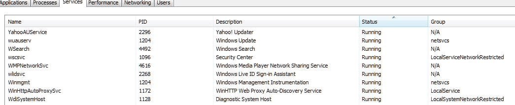

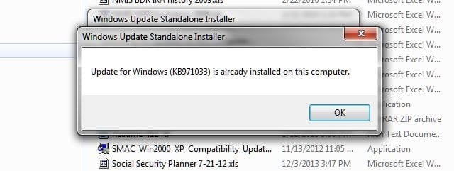

KB971033 is already installed on my pc.

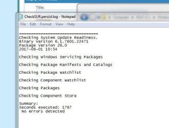

I can't zip the cbs.log (txt file). When I try it says "access denied". I could not open it with Notepad or Notepad++ to try to get a screen shot either.
I've uploaded screen shots of the only other txt files in the CBS folder. Not sure if they are what you need?

For the KB971033, I went to the Microsoft site and d/l'd that KB and attempted to install it but I got a window saying that it was already on my pc (see screen shot). The only option I get is to click OK. I don't get an option to reinstall it. I did this yesterday and repeated it just now.
