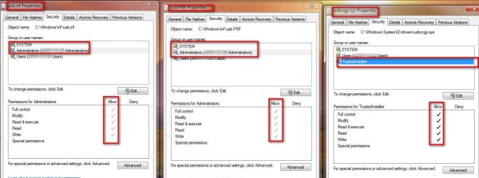

Your result indicates possible Windows driver corruption
Control Panel->Folder Options->View. Uncheck "Hide extensions for known file types". Click OK
Now, check if each of the files below exist. Tell me if any are missing.
For each .sys file, right click->Properties->Details and report the File Version of each
C:\windows\inf\usbstor.inf
C:\windows\inf\usbstor.pnf
C:\windows\system32\drivers\usbstor.sys
C:\windows\inf\usb.inf
C:\windows\inf\usb.pnf
C:\windows\system32\drivers\usbccgp.sys
/* EDIT */
p.s. "Access denied" on the Composite device could also be why the Teknet USB won't install/has no driver. (your flash drive is still a different matter). Also, try right click on the installer and run as Admin

If I might also add this:
Re: your flash drive problem. See How to Cleanup and Remove old USB Mass Storage Drivers. Follow the instructions and try re-connecting your flash drive
Re: Your web cam issue / Composite Device Access Denied
Let's go back and check the access permissions on these 3 files
For each file, right click->Properties->Security tab. (You'll see a snap shot for each below).
  1. For usb.inf; Select on SYSTEM and then Administrators. For each selection, verify you see the 5 check marks under Allow and nothing under Deny for each selection. (We don't care about Users)
  2. Check the same for usb.pnf: Select on SYSTEM and then Administrators, verify the 5 check marks under Allow and nothing under Deny. (We don't care about Users)
  3. For usbccgp.sys, select TrustedInstaller. verify the 5 check marks under Allow and nothing under Deny

Bonjour,
I had exactly the same problem with a HP Webcam HD 2300 and struggled a few weeks.
Bingo ICit2lol gave the right answer after passing the 3 spy/mal/ad ware removal tools I could install the driver
without any problem and the webcam works!
Thanks a lot.
