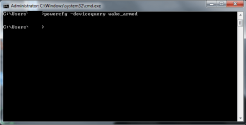

I did check via the porwercfg command at an elevated prompt. I had tried that previously and already cleared everything. Currently the command comes back blank.
Sorry about the hybrid sleep comment. The link showed to change the multimedia settings in advanced power management. While there I looked at everything and decided to enable hybrid sleep just to see if it would do anything.
I've updated my system specs. Let me know if you need anything else. Thanks for your help.

When you access Power Options>Advanced>Multimedia Settings>When Sharing Media, is it set to "Allow the computer to sleep"?
If that is set correctly, I don't know what else to suggest - except to examine your BIOS settings. I know it worked with XP, but there just might be something there that needs to be changed for Win7.
BTW - Your screenshot may not be an elevated command prompt. My elevated prompt reads " C: \Windows\system32>
This may make no difference, because I was able to run the "Powercfg -devicequery wake_armed" command from the normal CP.
