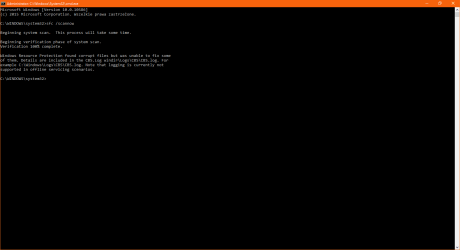

I'm having an exactly the same problem. I know I have a Windows 10 operating system, but I know it's not very relevant for this case and this thread exactly fits the problem.
I tried the sfc /scannow solution in cmd, but it only says "Windows Resource Protection found corrupt files but was unable to fix some of them" and nothing changes. I attach the screenshot.
Can you please help me with this?

Hey Hashim.
Thanks for your reply. My problem is still present.
Unfortunately I don't have such a program installed and I never had. And the problem is present since a fresh Windows install, when none of the additional programs were installed.
So unfortunately your advice doesn't solve it for me.
