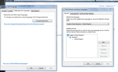

Hi Alotty,
Only 1 language allowed on Home premium, and Korean language packs are run on different paramaters, which is why this error is possibly being generated; from you CBS log
Error CSI 00000009 (F) Unable to parse identity version: [l:28{14}]"6.17601.17514"
In theory MS does not offer language packs to home premium users.
How did you install it Vistalator??
You can check here, (see screenshot)
can you also run this tool, copy/paste the results
http://go.microsoft.com/fwlink/?LinkID=52012
Uninstall the Korean language pack/program, it might just correct itself.

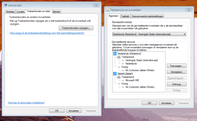

Hey Roy,
It seems I might have uninstalled the Korean language pack some time ago. I did find something else among the Language packs however.
I think the "Verenigde Staten (Internationaal)" (meaning United States - International) might belong there, though I'm uncertain as to the Japanese language option. Should I try to remove it via the same menu?

I have removed the Japanese language option, it does not seem to have had an effect.

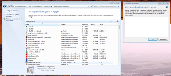

Hi Alotty,
SURT is still reporting a Korean identity in the Games section
Can you go
Control panel > Program & features >> turn features on/off (top left of GUI) a smaller window will open, takes a couple mins to populate
Uncheck Games
REBOOT
re run surt again

Hey roy,
I do not know why but the window that is supposed to allow you to turn features on or off is empty.
Should I go on with the rest of the steps in your post?
