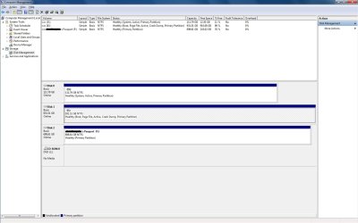

As for my disk management, here's a screenshot of the whole window:

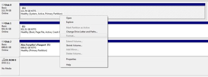

And here's what it looks like when I attempt to format the disk:
As you can see, there isn't actually an option to format the 120GB from my disk management window. The only way I've attempted to format the disk is straight from explorer.

Your Disk Management screenshot is showing you may be Dual booting, & have NO C: HD drive.
Therefore your D: is the boot drive & can not be formated.

You will need to move the data cable of the 1TB "Disk 1" to the #1 SATA port of the motherboard and set it as the second boot device after the CD/DVD drive and do the 3 separate startup repairs with the restarts discussed in this tutorial at the link below to create the "System" boot files to that Windows partition then the older HDD can be formatted.

Because you installed to new HD with old HD plugged in, it configured a Dual Boot placing the System files on the old HD. You need to recover the boot files into the new install by running Repairs with the old HD unplugged.
Once you swap the 1tb to DISK0, set as first HD to boot in BIOS setup then run 3 startup repairs from DVD/Repair CD until it starts on its own, you can plug back in the smaller HD as DISK1 to wipe it with Diskpart Clean All command: http://www.sevenforums.com/tutorials/52129-disk-clean-clean-all-diskpart-command.html

Your boot files are on the old 120GB drive, win7 won't let you format it because then your computer would not boot.
In your Disk Mangement snip, Disc0, where it says: "Healthy (System, Active, Primary partition)" the 'System' indicates where your boot files are, in this case the 120GB drive.
Follow the advice in the above posts and you will be able to boot your new OS and format the old drive.
