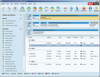

What is the 306mb FAT partition sitting on the boot sector of Disk1? Was it intended to boot G at some point? It doesn't correspond to any of the partitions on the source drive you cloned/imaged, so why would it be there - except to interfere?
Highlight Disk1 in PW, from Disk tab select Rebuild MBR, OK, Apply.
Power down to unplug the other HDD, boot into Win7 disk to run Startup Repair - Run up to 3 Separate Times.
If there isn't a good reason to have the 306mb partition, then use the PW disk to delete it, create a New Primary Partition there labeled System Reserved, Modify>Set to Active, OK, Rebuild MBR, OK, Apply steps. Reboot into WIn7 DVD to run the Repairs again.
If these fail then I'd test the drive and if okay reinstall or reimage. Your data is already safe, right?
LOL. It looks like that might have been the boot partition. But, it does correspond to the partitions on the original install that I ghosted over, which is Disk 2 in the screencap above. The 306 MB partition has the same files in it as the first (62.72MB) partition on Disk 2. Here is a screencap of that:
To me, those look like boot files. I don't know why the sizes of the partitions are different. Possibly some roundoff difference in how I partitioned the new disk when I ghosted to it. I recall that I wasn't able to make that partition the exact same size for whatever reason.
Is it possible that I should be trying to fix the boot process on that little partition, instead of on the larger one? Is there a way to go about that? It doesn't have a drive letter in that PW screencap and there was only "C:" shown in the list of Windows installations that comes up in the Startup Repair screen booted from the repair CD (with only that HD connected).

It's the Dell Diagnostics partition. See if you can boot it now: Run Built-In Diagnostics for Your Dell Computer | Dell US. If not you can delete it. There are no boot files there.
Then try again with C marked Active and all other HD's unplugged to run 3 Startup Repairs.
If it fails use PW CD to create a Primary partition in the 300mb space, label it System Reserved, Modify>Set to Active, OK., Rebuild MBR, OK, Apply. Reboot into DVD to run 3 repairs again.
This is all that can be done to start Win7 if you've already completed the other steps for Troubleshooting Windows 7 Failure to Start. Sometimes Win7 is irreparable.
Follow the steps in Clean Reinstall - Factory OEM Windows 7 to get and keep a perfect install, the opposite of the Factory Preinstall you had. Unplug all other HD's.
Progress! I was able to boot to the diagnostic partition and ran a diagnostic. FWIW, the hardware looks ok.
Trying the other steps now...
