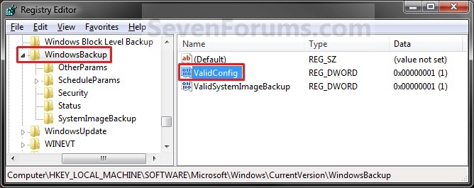

    3. In regedit, navigate to the location below (see screenshot below)
    HKEY_LOCAL_MACHINE\SOFTWARE\Microsoft\Windows\CurrentVersion\WindowsBackup
    4. In the right pane, right click on ValidConfig and click/tap on Delete. (see screenshot above)
    5. Click/tap on Yes to confirm deletion.

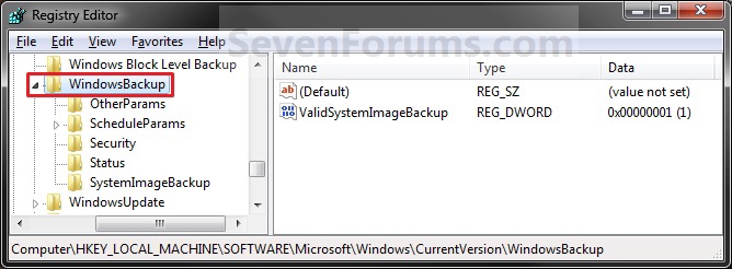

    6. The registry will now look like this. (see screenshot below)
    7. In the left pane, right click on ScheduleParams and click/tap on Delete. (see screenshot below)
    8. Click on Yes to confirm deletion.

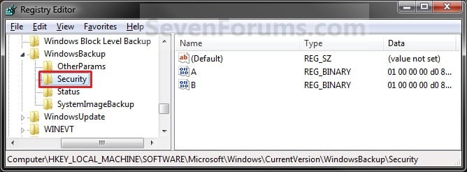

    9. In the left pane, right click on Security and click/tap on Delete. (see screenshot below)
    10. Click/tap on Yes to confirm deletion.

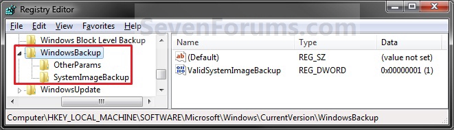

    13. The registry will now look like this. (2ee screenshot below)
    14. Close regedit.
