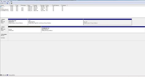

That service is set to Manual. Should it be automatic? And yes my drive is NTFS and has plenty of free space for it as you can see here.
That looks okay to me and manual is fine for that service.

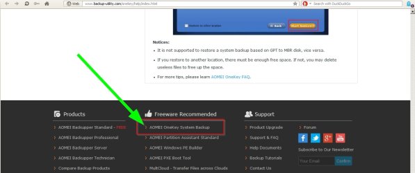

Forgot to mention that the download link is at the bottom of the page.
