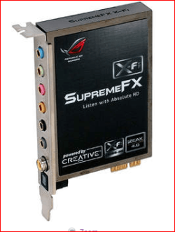

I am using the Supreme FX X-FI Audio Card that came with my Asus Crosshair III Formula motherboard.

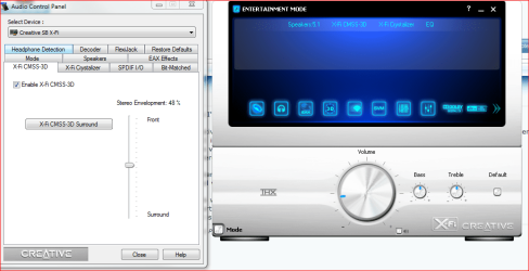

That right there more than anything. If you haven't installed the driver for it yet go here,
ASUSTeK Computer Inc.
in Downloads (select your OS), then under Audio download the SoundMAX Audio Driver V5.10.1.6605. Next under Utilities download "Sound Blaster X-Fi Utility V1.0(R19)". Once the driver and the X-Fi software is installed (and no you do not have a X-Fi, you have onboard Soundmax that uses some of the X-Fi software), you should then have one, the other or both of these,
and have the CMSS3D setting.
The motherboard manual say's I do, the the rise card is labeled as such.

Why yes it does,
Doesn't change the fact that it is not a X-Fi in any way, shape or form. It is nothing more than a riser card (you got that part correct) for the onboard audio, in place of having the audio chip on the motherboard. It is nothing more than a Soundmax based "card" that uses some of the X-Fi software (also known as "X-Fi MB). It does not and will not work with any drivers or software from Creative, they leave support for it up to whoever it was that sold/included it with thie product (in this case Asus).
Still going to need the driver and X-Fi software for it to work properly.

Its working now, that audio software did it, thanks.
