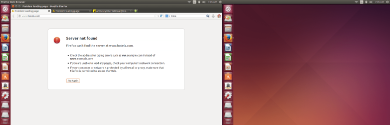

Update on your dds logs: (sorry it took so long, the logs are quite large and need to be looked through very carefully as it is easy to miss some things....)
This looks interesting! (from event viewer)
There are a few possible causes from this:
-You are using internet connection sharing
-Your dns cache needs wiped out. (but seeing at how this is done at every reboot, I doubt this is it)
-Your host file needs reset.
-Your network settings are configured wrong.
So I wold like you to do the following when you are done with the ubuntu stuff. (If you were not able to do that it is okay, just let me know)
1.) Reset your host file using this here: How can I reset the Hosts file back to the default? You can run the auto fix it from microsoft, or simply do the instructions listed on the page. (Please let me know what method you used.)
2.) Just for giggles, click
rb: type cmd. click the top result. A black box will appear. In the box, type this exactly with spaces:
If done correctly, it will report that the dns resolved cache was successfully flushed. Type exit and hit enter. Or close out like normal.
3.) Do you have any hide my IP software or vpn software installed? (Didn't see any in the log but just making sure.) Using open dns or google dns maybe?
4.) Try your browsers reset functions again. Ie reset (deleting personal settings), firefox safe mode, etc. Report what happens.
